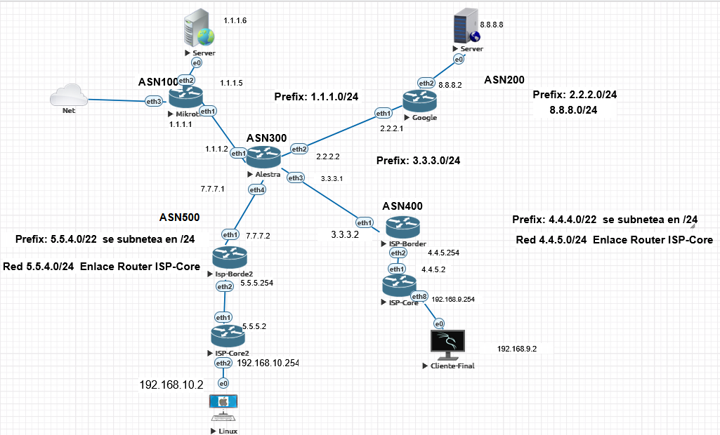

    Prueba 3
    Nombre:  caso3.png
Visitas: 9149
Tamaño: 124.5 KB
    Alestra
    set default as=300 redistribute-connected=yes redistribute-static=yes
    add address=1.1.1.2/30 comment=to-Facebook interface=ether1 network=1.1.1.0
    add address=2.2.2.2/24 comment=to-Google interface=ether2 network=2.2.2.0
    add address=3.3.3.1/24 comment=to-ISP-Borde interface=ether3 network=3.3.3.0
    add address=7.7.7.1/24 comment=to-ISP-Borde2 interface=ether4 network=7.7.7.0
    add network=3.3.3.0/24 synchronize=no
    add name=peer-to-facebook remote-address=1.1.1.1 remote-as=100
    add name=peer-to-google remote-address=2.2.2.1 remote-as=200
    add name=peer-to-isp-borde remote-address=3.3.3.2 remote-as=400
    add name=peer-to-isp-core2 remote-address=7.7.7.2 remote-as=500
    set name=Alestra
    Borde 2
    set default as=500
    add address=7.7.7.2/24 interface=ether1 network=7.7.7.0
    add address=5.5.5.254/24 interface=ether2 network=5.5.5.0
    add network=5.5.4.0/22 synchronize=no
    add name=peer1 remote-address=7.7.7.1 remote-as=300
    set name=Isp-Borde2
    Core 2
    add address=5.5.5.2/24 interface=ether1 network=5.5.5.0
    add address=192.168.10.254/24 interface=ether2 network=192.168.10.0
    add distance=1 gateway=5.5.5.254
    set name=ISP-Core

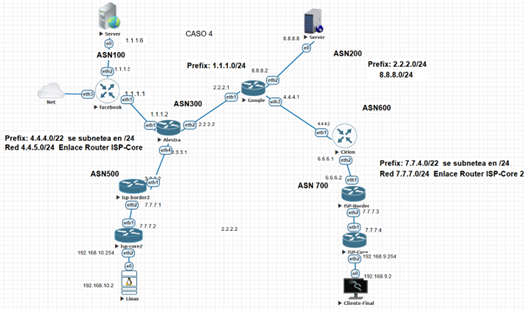

    Prueba 4
    Nombre:  caso4.png
Visitas: 9362
Tamaño: 141.1 KB
    Google
    set default as=200
    /interface bridge port
    add bridge=bridge1 interface=ether3
    add address=2.2.2.1/24 comment=to-Alestra interface=ether1 network=2.2.2.0
    add address=8.8.8.2/24 comment=to-Server-Google interface=ether2 network=\
    8.8.8.0
    add network=2.2.2.0/24 synchronize=no
    add name=peer-to-alestra remote-address=2.2.2.2 remote-as=300
    add name=peer1 remote-address=2.2.2.10 remote-as=600
    set name=Google
    Cirion
    /interface ethernet
    set [ find default-name=ether4 ] name=ether1
    set [ find default-name=ether1 ] name=ether2
    set [ find default-name=ether2 ] name=ether3
    set [ find default-name=ether3 ] name=ether4
    set default as=600 redistribute-connected=yes
    add address=2.2.2.10/24 interface=ether1 network=2.2.2.0
    add address=6.6.6.1/24 interface=ether2 network=6.6.6.0
    add network=6.6.6.0/24 synchronize=no
    add name=peer1 remote-address=2.2.2.1 remote-as=200
    add name=peer2 remote-address=6.6.6.2 remote-as=700
    set name=Cirion
    ISP-Borde3
    set default as=700
    add address=6.6.6.2/24 interface=ether1 network=6.6.6.0
    add address=7.7.7.1/24 interface=ether2 network=7.7.7.0
    add network=7.7.4.0/24 synchronize=no
    add name=peer1 remote-address=6.6.6.1 remote-as=600
    set name=ISP-Borde3
    ISP-Core3
    add distance=1 gateway=7.7.7.1
    set name=ISP-Core3

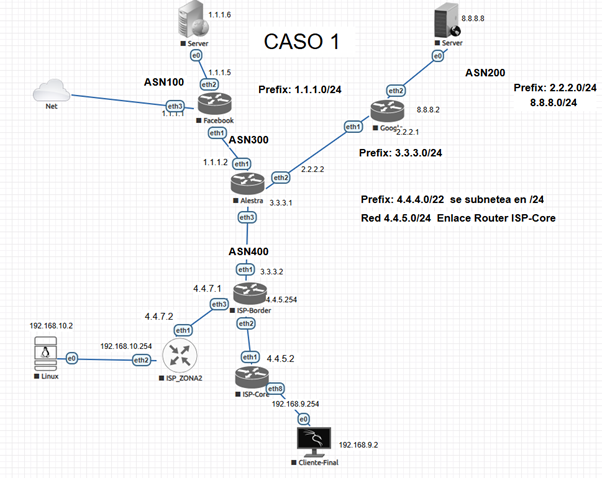

    Laboratorio full routing BGP y ruta por defecto BGP

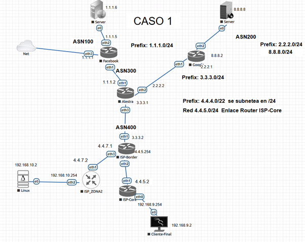

    CASO 1
    Agrega router ISP-Zona2 conectado a isp-borde y que use la red publica 4.4.7.0/24, luego agregas una laptop y puedas hacer ping hacía .8.8.8, 1.1.1.1, 2.2.2.1, 3.3.3.1
    Nombre:  casouno.png
Visitas: 8568
Tamaño: 156.0 KB
    ISP-BORDER
    set [ finddefault=yes ] supplicant-identity=MikroTik
    set default as=400 redistribute-connected=yesredistribute-static=yes
    addaddress=3.3.3.2/24 comment=to-Alestra interface=ether1 network=3.3.3.0
    addaddress=4.4.5.254/24 comment=to-ISP-Core interface=ether2 network=4.4.5.0
    addaddress=4.4.7.254/24 comment=to-ISP-Core interface=ether3 network=4.4.7.0
    adddisabled=nointerface=ether1
    addnetwork=4.4.4.0/22 synchronize=no
    addnetwork=4.4.5.0/24 synchronize=no
    addnetwork=4.4.7.0/24 synchronize=no
    addname=peer-to-alestra remote-address=3.3.3.1 remote-as=300
    setname=Borde
    ZONA 2
    addaddress=4.4.7.2/24 interface=ether1 network=4.4.7.0
    addaddress=192.168.10.254/24 interface=ether2 network=192.168.10.0
    addaction=masquerade chain=srcnat out-interface=ether1
    adddistance=1 gateway=4.4.7.254
    setname=Zona2
    setenabled=yes

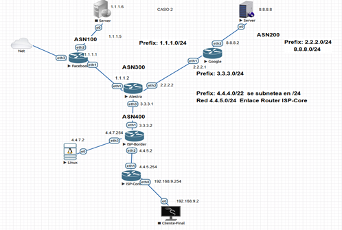

    CASO 2
    Ahora elimina router ISP-zona2, y conecta una laptop enether3 directamente a ISP Borde, y asigna una ip de la red 4.4.7.0/24. Luego has pinga 8.8.8.8,1.1.1.1,2.2.2.1, 3.3.3.
    Nombre:  CASO2.png
Visitas: 8706
Tamaño: 106.3 KB
    ALESTRA
    add address=1.1.1.2/30 comment=to-facebook interface=ether1 network=1.1.1.0
    add address=2.2.2.2/24 comment=to-google interface=ether2 network=2.2.2.0
    add address=3.3.3.1/24 comment=to-isp-border interface=ether3 network=3.3.3.0
    add network=3.3.3.0/32 synchronize=no
    add name=peer-to-isp-border remote-address=3.3.3.2 remote-as=400
    set name=Alestra
    ISP-BORDER
    set default as=400
    add address=3.3.3.2/24 comment=to-alestra interface=ether1 network=3.3.3.0
    add address=4.4.5.254/24 comment=to-isp-core interface=ether2 network=4.4.5.0
    add address=4.4.7.254/24 comment=pc interface=ether3 network=4.4.7.0
    add network=4.4.4.0/24 synchronize=no
    add network=4.4.5.0/24 synchronize=no
    add network=4.4.6.0/24 synchronize=no
    add network=4.4.7.0/24 synchronize=no
    add name=peer-to-alestra remote-address=3.3.3.1 remote-as=300
    set name=Isp-border

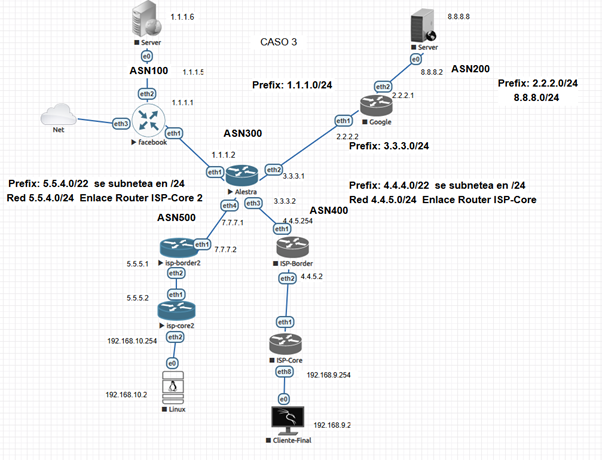

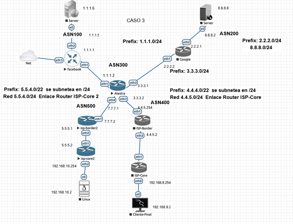

    CASO 3
    Agrega una sesion BGP con alestra con el ASN500, con router ISPborde2, ISP Core 2 y laptop. Usarasla red5.5.4.0/22, lo subneteas a /24, y solo anuncia la red 5.5.6.0/24 enisp borde. ISP Borde2->ASN500, red5.5.4.0/22, subnetear a /24 yusar 5.5.6.0/24 Puedes hacer ping al8.8.8.8,1.1.1.1, 2.2.2.1, 3.3.3.1 desde isp Borde2, ispcore2 y la laptop
    Nombre:  CASO3.png
Visitas: 8712
Tamaño: 154.0 KB
    ALESTRA
    set name=Alestra
    BORDE 2
    set default as=500
    set name=Isp-Borde2
    CORE 2
    set name=ips-core2
