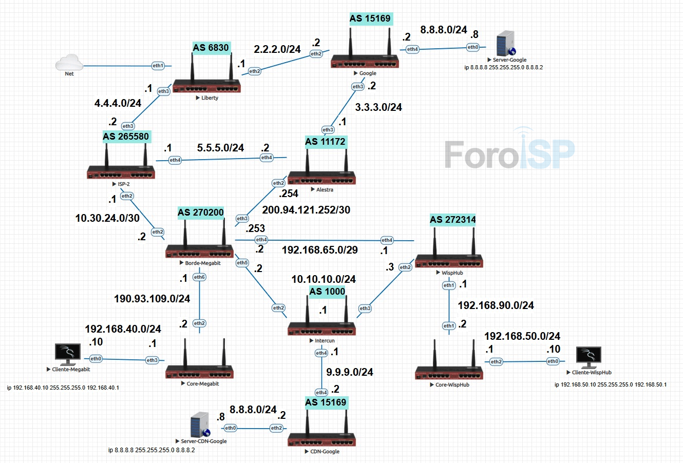

Tema: Laborario BGP IPv4 entre ISPs y CDN
    Avatar de josemiguel
    08 Sep, 22
    53
    Nombre:  Diagrama-BGP-ISP-CDN.png
Visitas: 2909
Tamaño: 213.2 KB
    1 Importar laboratorio de EVE-NG
    _Exports_unetlab_export-20250503-204003.zip
    2 Poner los Scripts en los Router
    Google
    /routing bgp instance set default as=15169
    add address=2.2.2.2/24 comment=to-Liberty interface=ether2 network=2.2.2.0
    add address=8.8.8.2/24 comment=to-Server-Google interface=ether4 network=8.8.8.0
    add address=3.3.3.2/24 comment=to-Alestra interface=ether3 network=3.3.3.0
    /routing bgp network add network=8.8.8.0/24 synchronize=no
    add name=peer-to-liberty remote-address=2.2.2.1 remote-as=6830
    add name=peer-to-alestra remote-address=3.3.3.1 remote-as=11172
    /system identity set name=Google
    /tool romon set enabled=yes
    Liberty
    /routing bgp instance set default as=6830 redistribute-connected=yes
    add address=2.2.2.1/24 comment=to-Google interface=ether2 network=2.2.2.0
    add address=4.4.4.1/24 comment=to-ISP-2 interface=ether3 network=4.4.4.0
    add name=peer-to-google remote-address=2.2.2.2 remote-as=15169
    add name=peer-to-isp-2 remote-address=4.4.4.2 remote-as=265580
    /system identity set name=Liberty
    ISP-2
    /routing bgp instance set default as=265580 redistribute-connected=yes
    add address=4.4.4.2/24 comment=to-Liberty interface=ether3 network=4.4.4.0
    add address=5.5.5.1/24 comment=to-Alestra interface=ether4 network=5.5.5.0
    add address=10.30.24.1/30 comment=to-Borde-Megabit interface=ether2 network=10.30.24.0
    add name=peer-to-Liberty remote-address=4.4.4.1 remote-as=6830
    add name=peer-to-Alestra remote-address=5.5.5.2 remote-as=11172
    add name=peer-to-Borde-Megabit remote-address=10.30.24.2 remote-as=270200
    /system identity set name=ISP-2
    Alestra
    /routing bgp instance set default as=11172 redistribute-connected=yes
    add address=3.3.3.1/24 comment=to-Google interface=ether3 network=3.3.3.0
    add address=5.5.5.2/24 comment=to-ISP-2 interface=ether4 network=5.5.5.0
    add address=200.94.121.254/30 comment=to-Borde-Megabit interface=ether2 network=200.94.121.252
    add name=peer-to-google remote-address=3.3.3.2 remote-as=15169
    add name=peer-to-ISP-2 remote-address=5.5.5.1 remote-as=265580
    add name=peer-to-Borde-Megabit remote-address=200.94.121.253 remote-as=270200
    /system identity set name=Alestra
    Borde-Megabit
    /routing bgp instance set default as=270200 redistribute-connected=yes
    add address=200.94.121.253/30 comment=to-Alestra interface=ether3 network=200.94.121.252
    add address=192.168.65.2/29 comment=to-isp-borde-wisphub interface=ether4 network=192.168.65.0
    add address=10.30.24.2/30 comment=to-ISP-2 interface=ether2 network=10.30.24.0
    add address=190.93.109.1/24 comment=to-Core-Megabit interface=ether6 network=190.93.109.0
    add address=10.10.10.2/24 comment=to-Intercun interface=ether5 network=10.10.10.0
    /routing bgp network add network=190.93.109.0/24
    add in-filter=ruta_larga name=peer-to-Alestra remote-address=200.94.121.254 remote-as=11172
    add name=peer-to-isp-borde-wisphub remote-address=192.168.65.1 remote-as=272314
    add name=peer-to-ISP-2 remote-address=10.30.24.1 remote-as=265580
    add name=peer-to-Intercun remote-address=10.10.10.1 remote-as=1000
    /routing filter add action=accept chain=ruta_larga set-bgp-prepend=2
    /system identity set name=Borde-Megabit
    WispHub
    /routing bgp instance set default as=272314
    add address=192.168.90.1/29 comment=to-isp-core-wisphub interface=ether1 network=192.168.90.0
    add address=10.10.10.3/24 comment=to-ixp interface=ether2 network=10.10.10.0
    add address=192.168.65.1/29 comment=to-isp-borde-megabit interface=ether4 network=192.168.65.0
    add network=192.168.90.0/29
    add network=192.168.65.0/29
    add name=peer_to_ixp remote-address=10.10.10.1 remote-as=1000
    add name=peer_to_megabit remote-address=192.168.65.2 remote-as=270200
    /system identity set name=WispHub
    Intercun
    /interface bridge add name=bridge-to-bordes
    /routing bgp instance set default as=1000 redistribute-connected=yes
    /interface bridge port
    add bridge=bridge-to-bordes interface=ether2
    add bridge=bridge-to-bordes interface=ether3
    add address=10.10.10.1/24 comment=Bordes-ISP interface=bridge-to-bordes network=10.10.10.0
    add address=9.9.9.1/29 comment=to-CDN-Google disabled=yes interface=ether4 network=9.9.9.0
    add name=peer-to-borde-wisphub remote-address=10.10.10.3 remote-as=272314
    add name=peer-cdn-google remote-address=9.9.9.2 remote-as=15169
    add name=peer-to-Borde-Megabit remote-address=10.10.10.2 remote-as=270200
    /system identity set name=Intercun
    CDN-Google
    add address=9.9.9.2/29 comment=to-intercun interface=ether4 network=9.9.9.0
    add address=8.8.8.2/24 comment="RED CDN" interface=ether2 network=8.8.8.0
    add name=peer-to-intercun remote-address=9.9.9.1 remote-as=1000
    /system identity set name=CDN-Google
    Core-Megabit
    add address=190.93.109.2/24 comment=to-Borde-Megabit interface=ether2 network=190.93.109.0
    add address=192.168.40.1/24 comment=LAN-Clientes-Megabit interface=ether3 network=192.168.40.0
    add distance=1 gateway=190.93.109.1
    /system identity set name=Core-Megabit
    Core-Wisphub
    add address=192.168.90.3/29 comment=to-isp-borde-wisphub interface=ether1 network=192.168.90.0
    add address=192.168.50.1/24 comment=LAN interface=ether2 network=192.168.50.0
    add comment=WAN distance=1 gateway=192.168.90.1
    /system identity set name=Core-Wisphub
